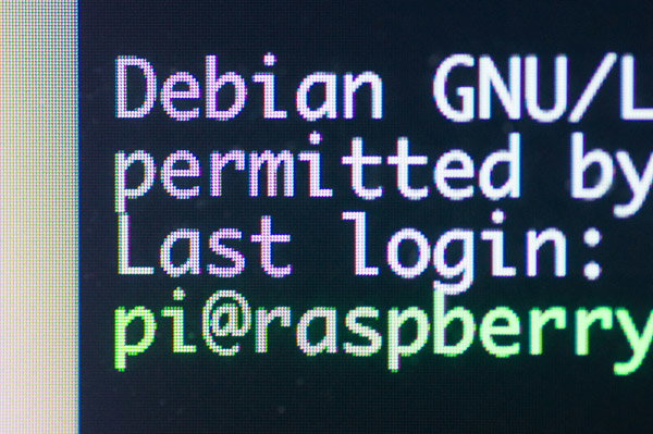

Assuming that was successful, you should land in a terminal that is running on your Pi! You can now do things like install software, program HATs and pHATs, etc, all without having a display, keyboard, or mouse attached to your Pi!
