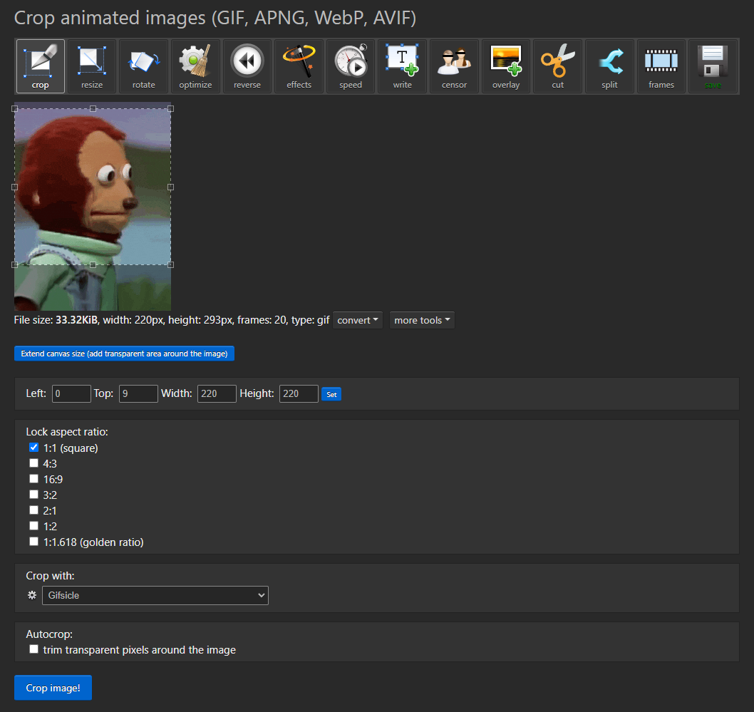

Cropping
This GIF is rectangular, so first we need to make it square using https://ezgif.com/crop
Cropping the GIF
Even if your GIF is already the correct aspect ratio, cropping can be useful if you're doing stuff with retro video game animations or pixel art - it will look nicer and crispier if you can get the pixels to match up with the LEDs.

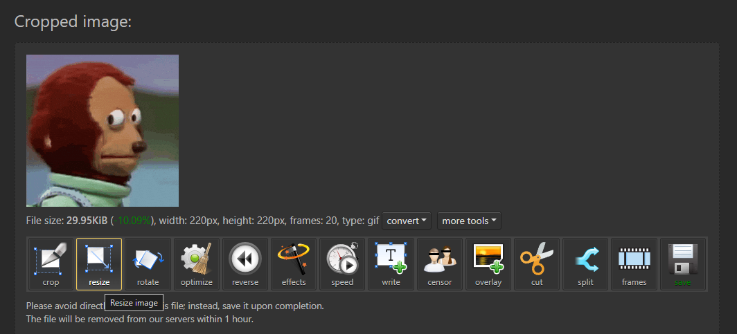

Resizing
Next we're resizing our image to match the dimensions of our display.
Scroll down to the bottom of the page to view the cropped version of our image, and click 'resize' (or if you skipped the cropping step, head to https://ezgif.com/resize):
Clicking the resize button
Resize to 128x128 pixels:
Resize to 128x128
Scroll down, and you'll see a version of the GIF that's square and resized to 128x128.

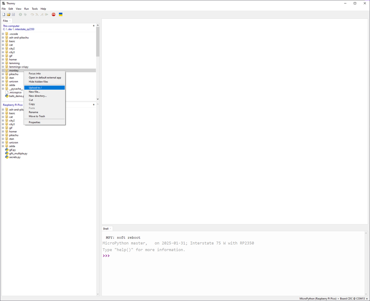

Fire up Thonny and make sure the Files window is visible. If it's not, you can enable it with the 'View' menu.
Navigate to the directory with the .png frames in it using the Files window. Right click on the directory and choose 'Upload to /' to copy it to your Interstate board.
Copying files with Thonny

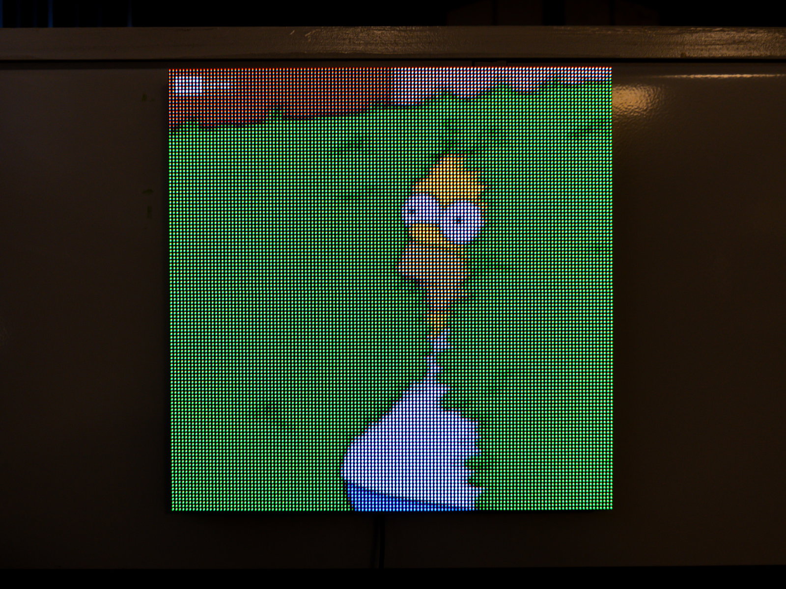

Displaying a GIF
gif.py is our example that displays a single GIF by cycling through all the .png files that are present in a directory, one by one.
You can find the code on GitHub here. It might already be present on your Interstate if you installed the -with-examples version of MicroPython.
The default directory that this example looks in for image files is called /gif . Our files are stored in a directory called /monkey, so we've changed that in the code.
Running the GIF example
Press the green run button in the Thonny's menu bar to run the code. If it's cycling too fast or two slow, you can adjust the INTERVAL value to change how long it pauses before switching to the next image.
