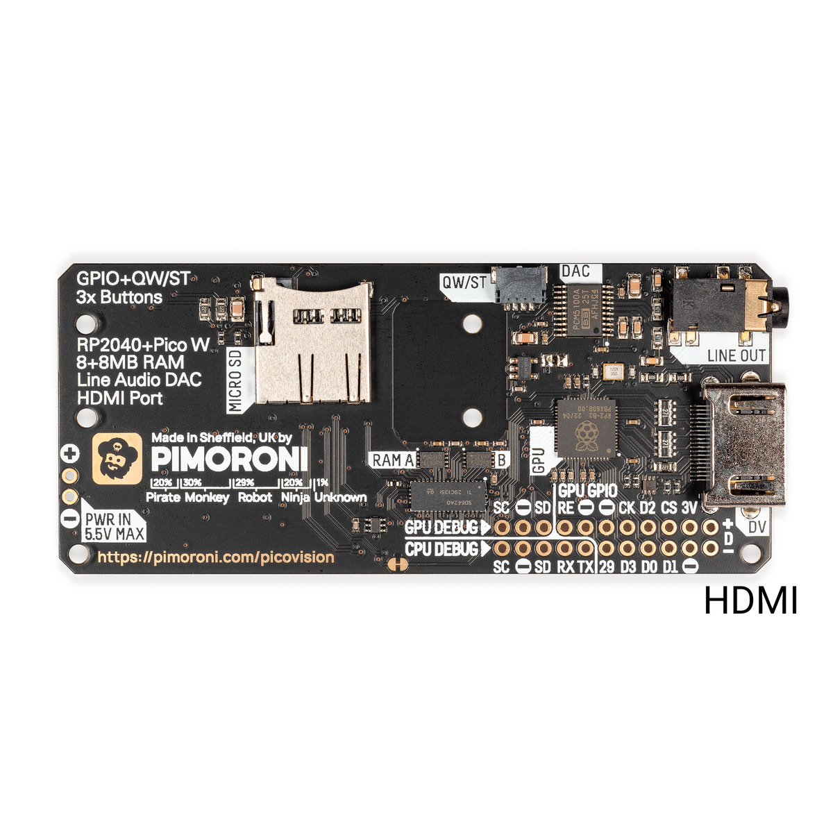

To get started, plug one end of the HDMI cable into a spare HDMI connector on your monitor or TV. The other end plugs into the HDMI shaped connector on PicoVision (it's labelled DV, for legal reasons).
PicoVision with the DV/HDMI connector labelled
The USB cable goes from your computer to the micro USB port on the Pico W, this is how we'll provide it with power and also how we'll program the board. If you're just checking out the pre-loaded examples and aren't planning on programming the board just yet you could plug it into any convenient USB power source (perhaps your TV has one?).
PicoVision with the USB power/data connector labelled

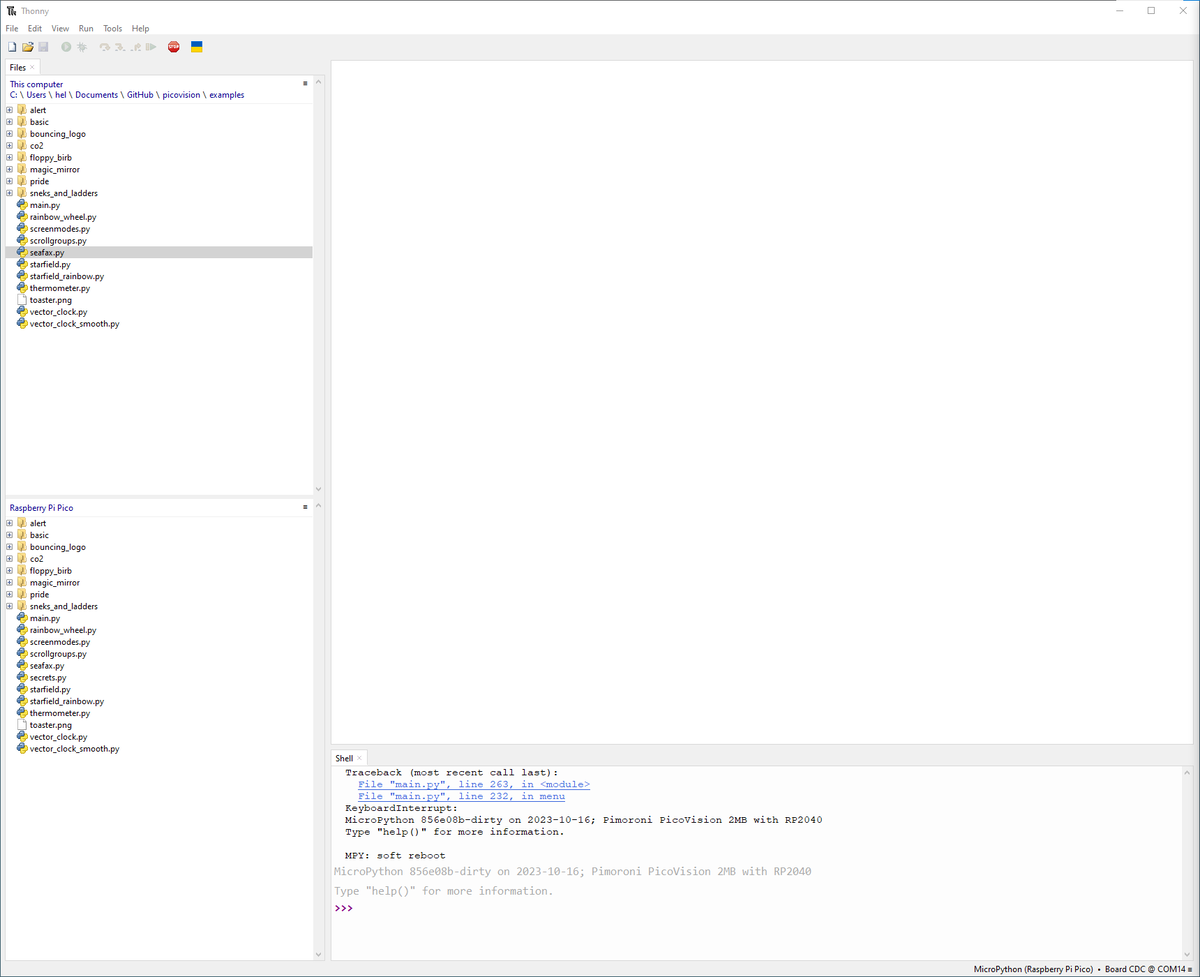

  • Plug your PicoVision into your computer, if it's not plugged in already. Because PicoVision is busy running the launcher program, main.py will already be running, you may need to interrupt it with the stop button in Thonny before sending it any instructions. In recent versions of Thonny, there's an option to interrupt running programs automatically - if you want to turn that on it's under Tools > Options > Interpreter > Interrupt working program on connect.
  • After you press stop, you should get a MicroPython prompt that looks something like this. The >>> in the 'Shell' box tells you that PicoVision is talking to your computer and is ready to accept instructions.

Using Thonny, you can open up the .py example files on the device and edit them. To see the files on your board, you will need to have the Files window visible - if you can't see it, you can make it show up with View > Files.
Screenshot showing the Files window in Thonny
The top box can be used to browse the local files in on your computer, and the bottom box shows the files on your board. If you want to transfer files to (or from) your board, right click on the file you want to copy and select 'upload to /' or 'download to /'.
