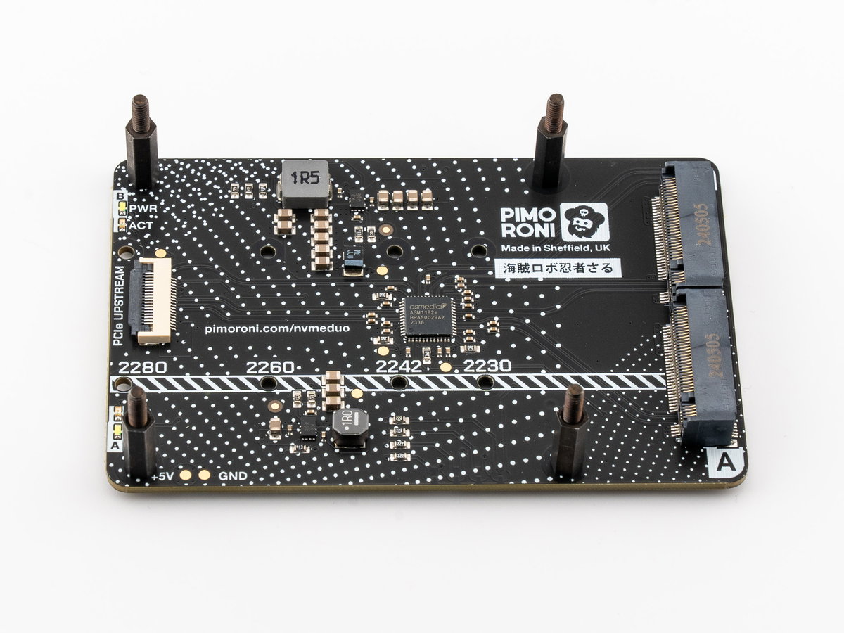

Attach the long standoffs to the top of the base with four of the short M2.5 screws.
NVMe Base Duo with Standoffs
Alternate base assembly (with HAT)
If you are planning on mounting a HAT (or other hardware) on top of your Pi 5, you might find it useful to use the longer screws.
Attach the long standoffs to the top of the base with four of the long M2.5 screws. The screw thread will poke out of the top of the standoff, providing some handy mounting points that you can attach your HAT's standoffs to.
NVMe Base Duo with HAT Standoffs

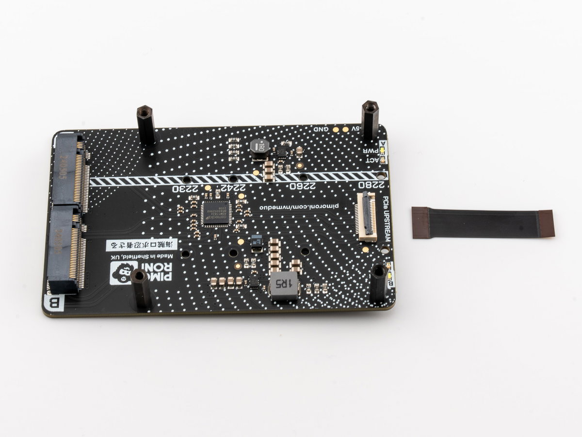

The ribbon cable
We suggest connecting the ribbon cable to the base next, before you attach anything else to it.
One end of the cable is wider and is labelled ADDON - this is the end which goes into the connector on the base. The other end (labelled RPI 5) goes into the Raspberry Pi 5's PCIe connector.
The Ribbon Cable
When the Base is in its final position, the writing and Pirate logo will face outwards.
Attaching the ribbon cable to the base

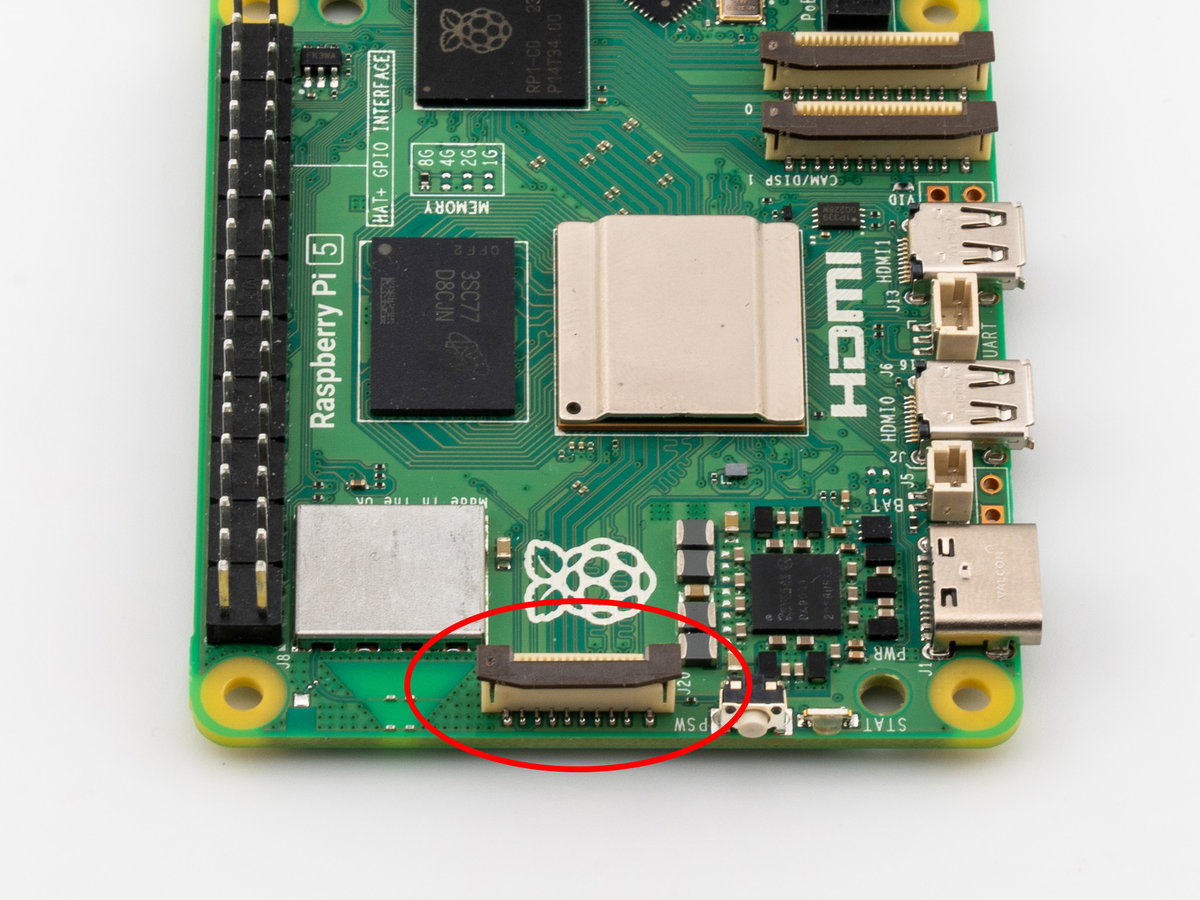

Locate the Raspberry Pi 5 PCIe connector - it is located next to the Pi's on/off switch. It has a brown clip which slides up and down, at right angles to the Raspberry Pi board.
The Raspberry Pi 5 PCIe Socket
Carefully lift the clip up by about 1mm.
With the Raspberry Pi on your desk, hold your base directly above the Pi's PCIe connector with the SSD pointing away from the Pi.
NVMe Base ribbon being offered up to the PCIe Socket
Gently lower the Base, posting the ribbon into the PCIe connector until you feel that it has gone as far as it can. With your thumb nail or tweezers, push the brown clip down and back in place.

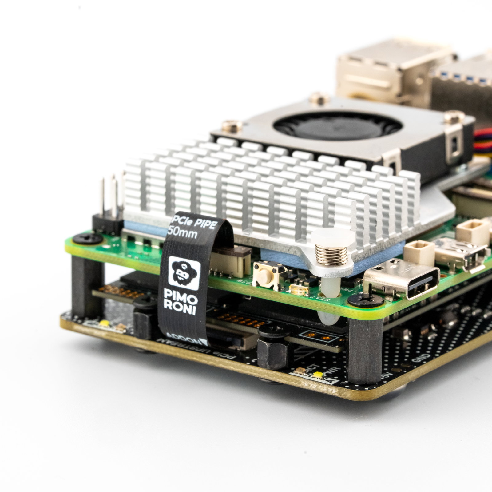

Now that the two boards are connected, fold the base down under the Raspberry Pi as though the ribbon cable is a hinge. Make sure you don't put the ribbon under any strain.
With the Raspberry Pi sitting on top of the base, use the four remaining short screws to secure the Raspberry Pi 5 on top of the base's spacers.
NVMe Base secured to a Raspberry Pi without HAT
If you used the long screws to attach the standoffs, post the long screws through the four mounting holes of the Pi, and then screw the HAT's spacers onto the threads.
