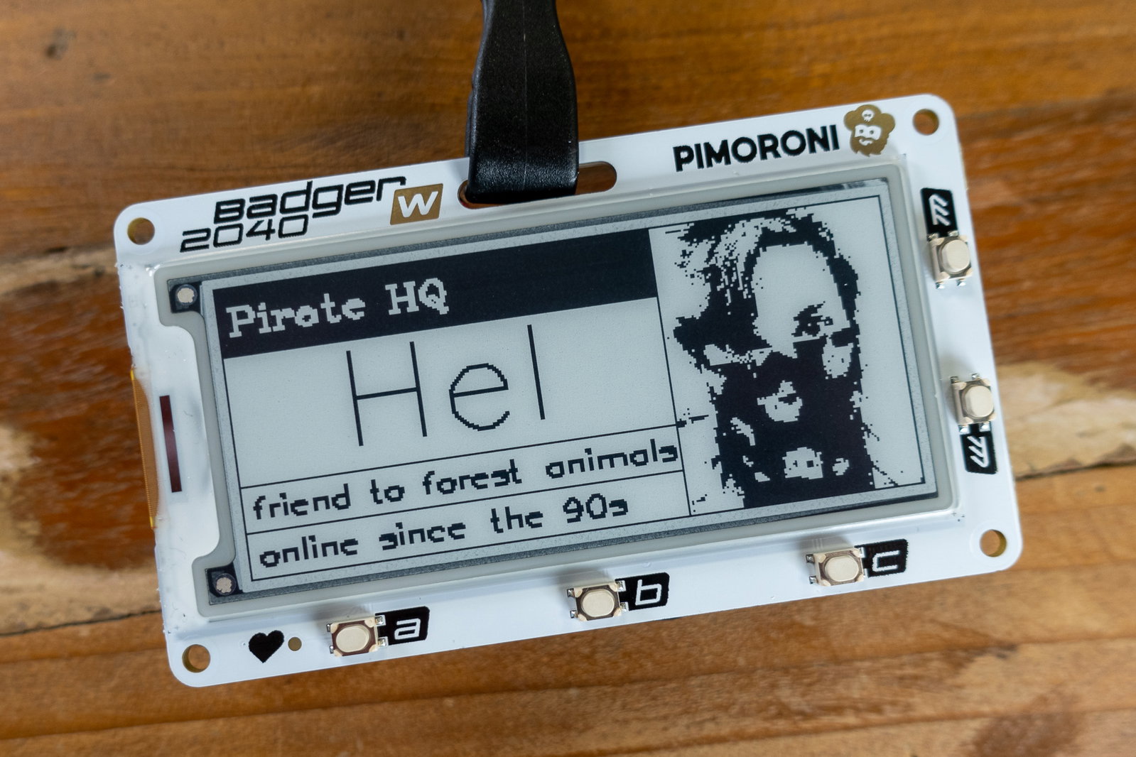

badge.py
The data files for the badge example are stored in the badges directory on the device.
To change the text on the namebadge example, edit badge.txt. You can double click on badge.txt in the Files menu to open it up in Thonny (remember to save the file when you're done, and then hit reset on the board to reload the launcher).
To change the image, replace badge.jpg with another 104 x 128 pixel (non-progressive) jpeg.

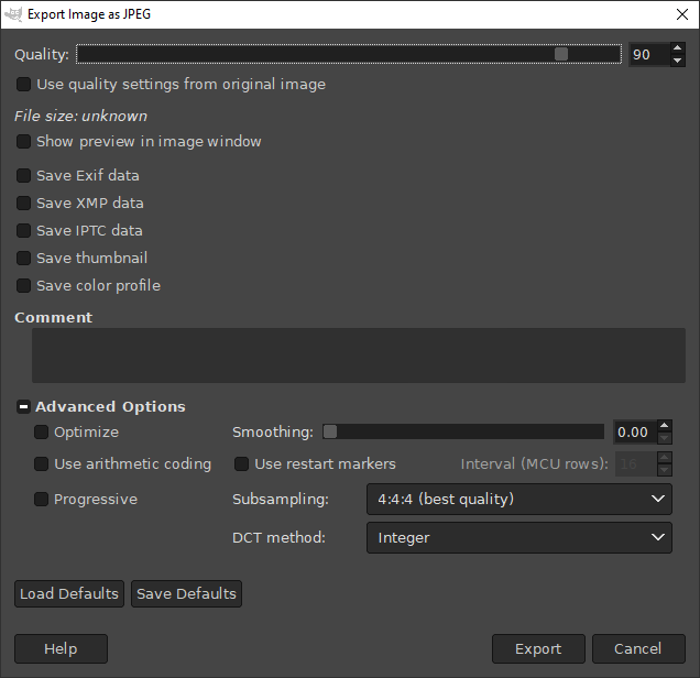

Our jpeg decoder jpegdec will attempt to dither your image into a 1-bit colour palette - we've found images with a lot of contrast turn out best. If you want more control over what your image will look like, you could convert it into a 1-bit image yourself using image editing software. In GIMP, you can do this with 'Image > Mode > Indexed... > Use black and white (1-bit) palette'.
Make sure you export your jpeg without progressive encoding. We've had good results from turning off jpeg optimization as well (in GIMP, you can find these settings under 'advanced options').
Screenshot showing how to export a jpeg using GIMP
