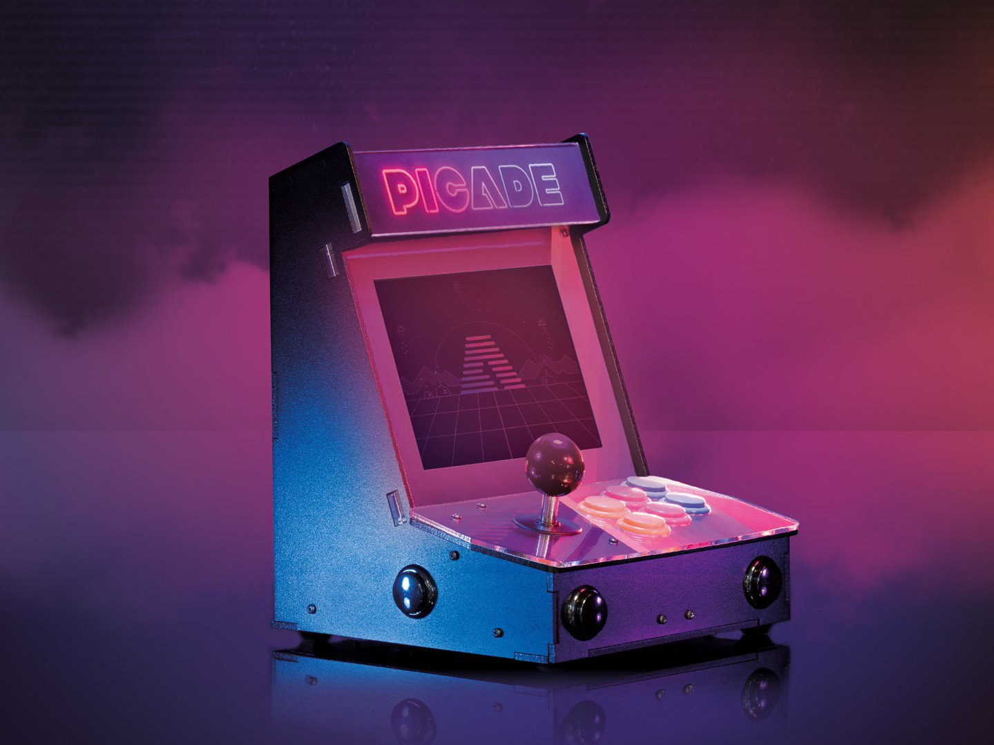

Assembling your Picade - 2018 edition
Learn how to assemble and set up your Picade!
23 August 2018 · Tutorial · about 45 minutes
This tutorial will show you how to build your 2018 edition Picade. It incorporates the text from the included assembly instructions, with some important updates and additional information, and the videos for each section of the Picade build video. Take note of the important information in bold, as these are corrections to the text of the assembly instructions included with your Picade.
