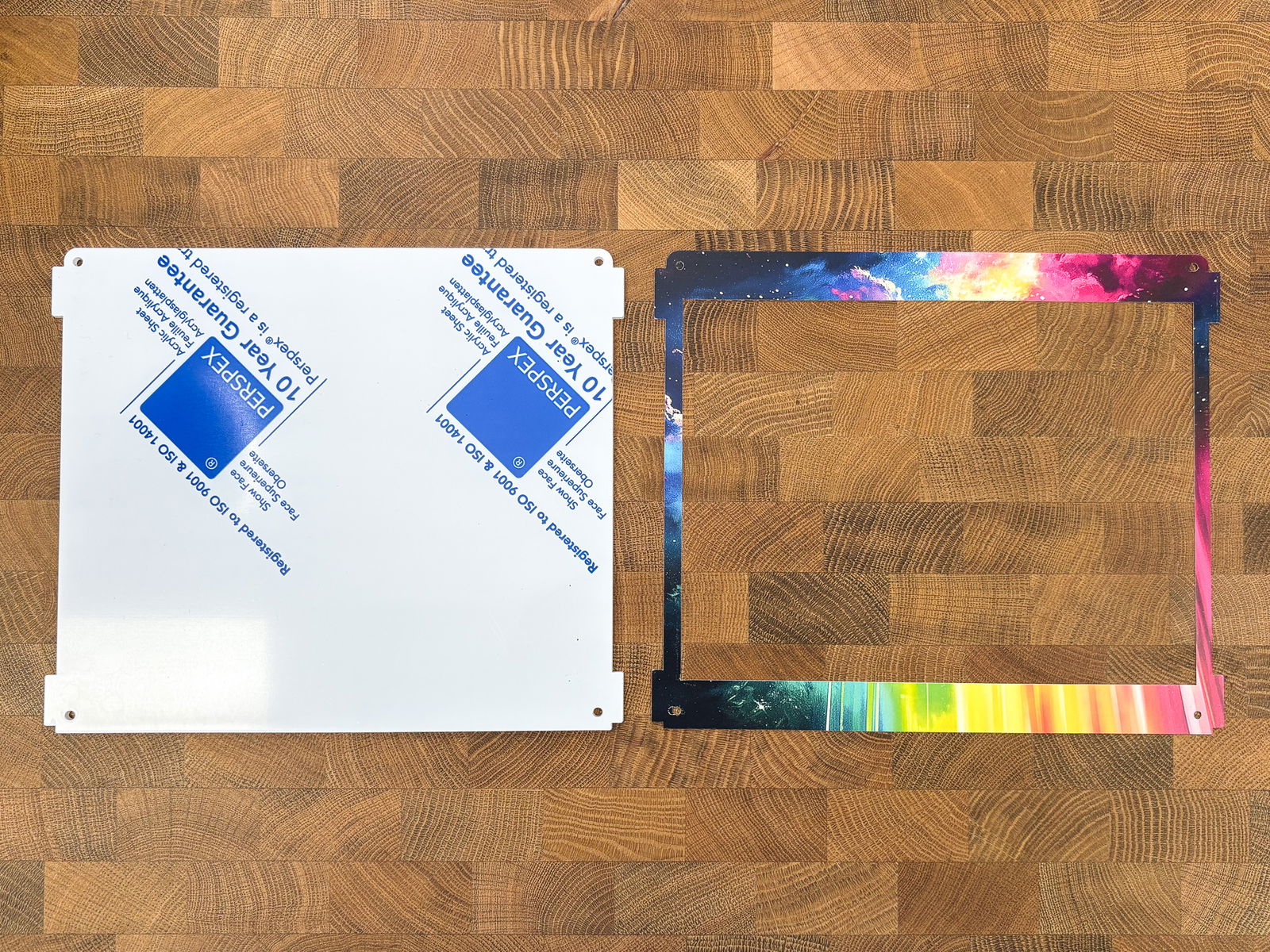

Take the large square acrylic piece and lay it down with the tabs on either side, and the curved edge at the top.
All of the acrylic pieces come with protective film on both sides. You'll need to peel this off each of the pieces as you use them, but we'll be leaving the layer on the outside of this large screen piece until the end of the build to protect it.
Peel off the protective layer on one side of the large screen piece. This will be the inside of the screen assembly so try not to get any dust, fingerprints, crumbs or pet hair on this surface, as it will be difficult to get rid of once the pieces are sandwiched together.
Place the screen surround artwork face down onto the exposed acrylic, also with the curved edge at the top.

For the next part you'll need:
  • 2x transparent acrylic marquee pieces
  • 1x marquee artwork
  • 1x wooden panel C
  • 4x M3 screws
  • 4x M3 nuts
Remove the protective layer from one of the pieces of acrylic.
Put the artwork on top of the acrylic layer, with the printed side of the artwork touching the exposed acrylic.
Remove the protective layer from both sides of the other piece of acrylic, and put it on top of the artwork.
If you want to leave the protective coating on the front of the marquee sandwich attached for now, unpeel it from the tabs as before
Now you can slot the marquee sandwich into the corresponding slots on the cabinet, with the art side pointing forwards. Note that the display assembly will do its best to escape from its slots at this point, so it's very helpful to have an extra pair of hands holding it in place.
